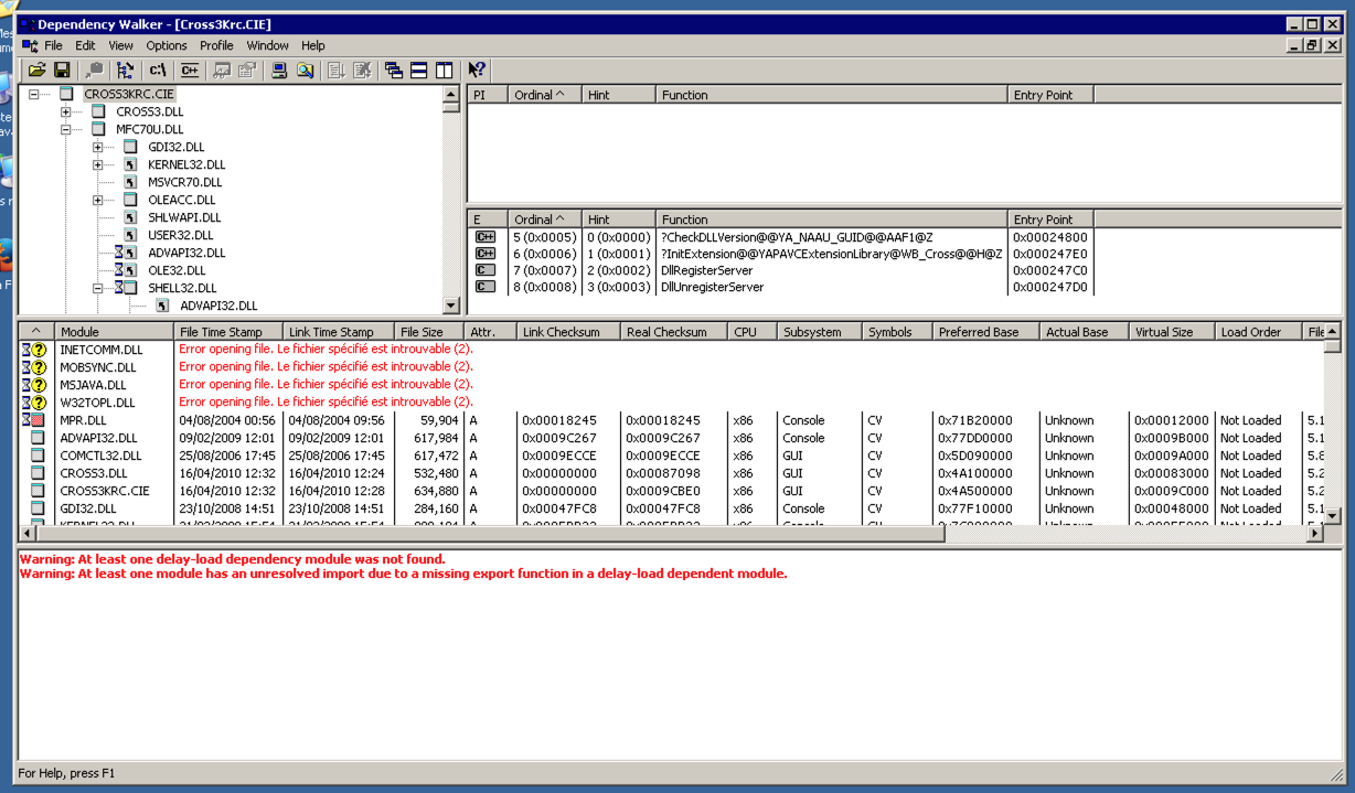

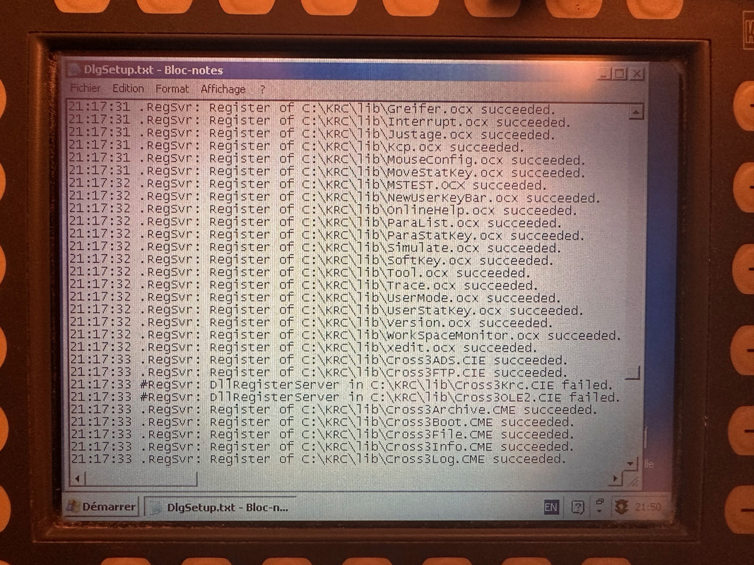

- DlgSetup.txt contains:
- #RegSvr: DllRegisterServer in C:\KRC\lib\Cross3Krc.CIE failed
- #RegSvr: DllRegisterServer in C:\KRC\lib\Cross3OLE2.CIE failed
- Running Cross3.exe open a dialog box containing "Can't find entry point in WBF_time.dll"

I assume there is a problem with the MFC card.
Do you know how to test the MFC card ?
