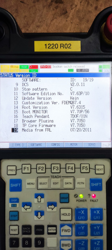

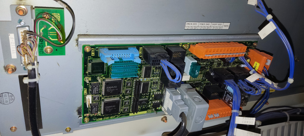

    Hello.. i have a r2000ib 210f with r30ia controller. The robot doesn't have operating buttons and mode switch on the controller but have the operator board. I ordered the buttons and a 3mode switch i plugin to the board and all works good accept the 3mode switch. The fault code is SYSTEM 301 external mode select is not available .

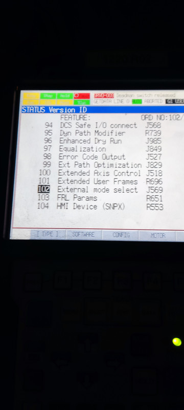

    I guess the External Mode Select option (J569) is still installed on your controller which is not compatible with a physical mode switch. If you want to use the 3 mode switch, the External Mode Select option has to be removed from your system.

    Hello.. i think the information at the photos is fine to find the problem 🙂. And show the board before and after plugin the buttons and 3mode switch. At the time i have unplug the 3mode switch and the robot is auto mode

    Select MENU > STATUS > Version ID > CONFIG and check if the External Mode Select option is still installed on your controller.
  • johnsk8
    Posts
    19
    • October 27, 2023 at 8:14 AM
    • #16
    Yes is j569 is still installed. And now how to remove ">

    Quote from johnsk8
    Yes is j569 is still installed. And now how to remove IMG-20231027-080949.jpg">
    At least in Europe you have to request a new image from FANUC. Once uninstalled it is not possible to simply reinstall a (paid) option.
    I'm not sure if you can uninstall it by your own. I have never tried this.
  • HawkME
    Reactions Received
    568
    Trophies
    11
    Posts
    3,268
    • October 28, 2023 at 12:48 PM
    • #20
    Unfortunately you can't uninstall options. Take an image backup, then you must request and pay for a reburn software set from Fanuc.
