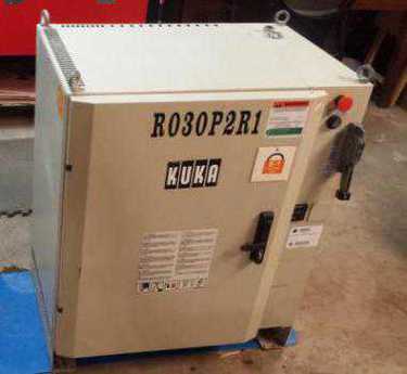

is this controller and this robot: https://usedrobotstrade.com/es/kuka-kuka-krc1-controller
yes, it is one of variants. image shows it has different disconnect switch (rotary) and the cabinet door is open. at such old product label is often degraded or damaged but there is a backup label inside on the right wall.

no... the first photo is label of the KUKA PC. each component has label. but cabinet also has one and it will show things like power requirement (400V 25A or similar)
