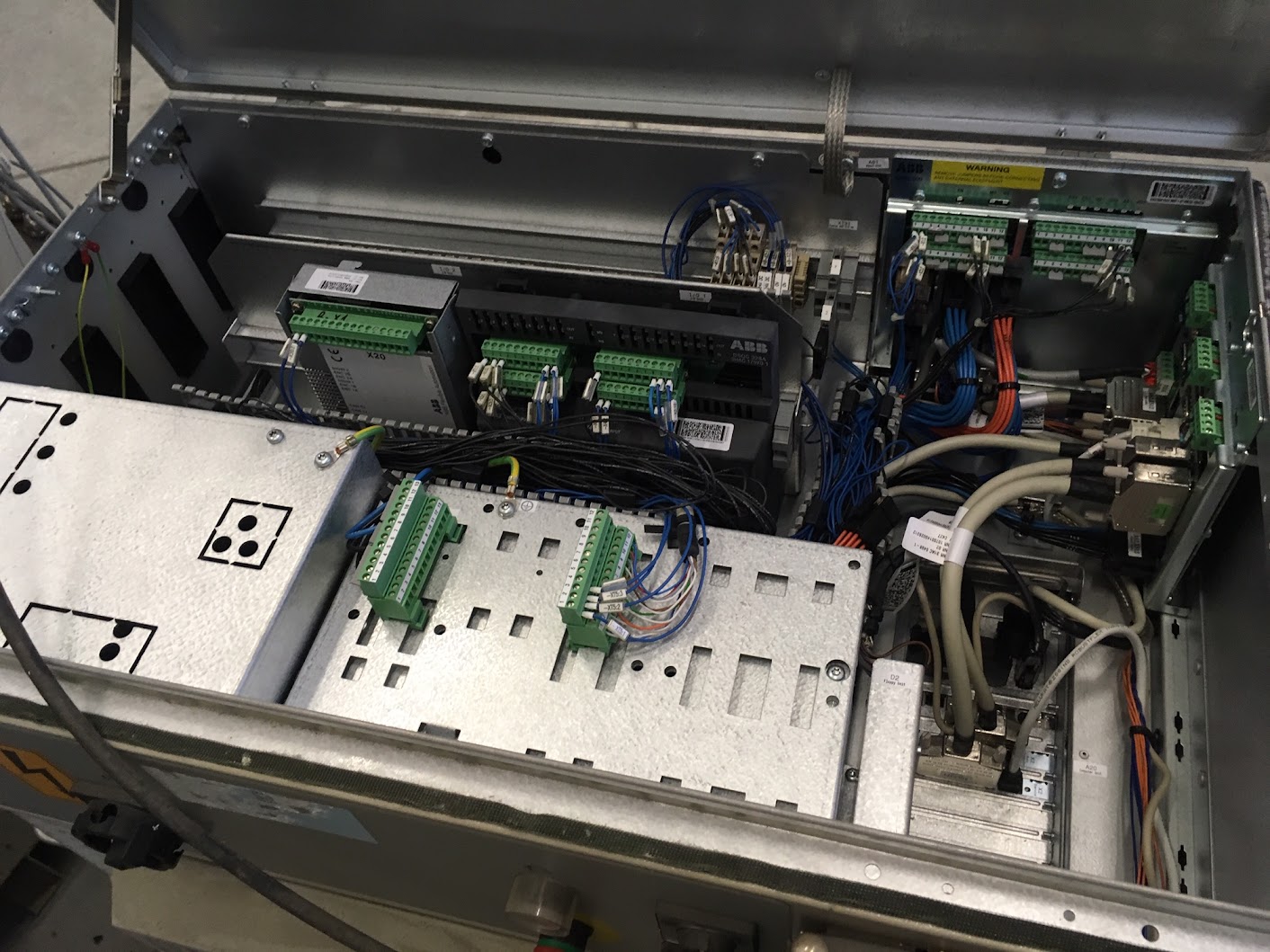

  • Hello,

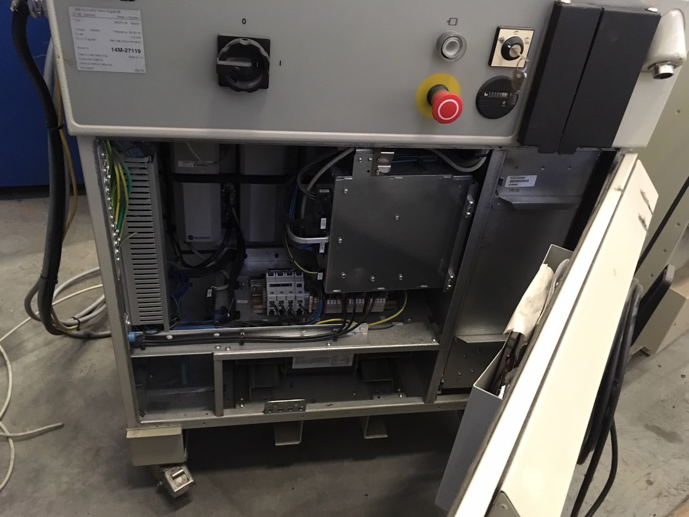

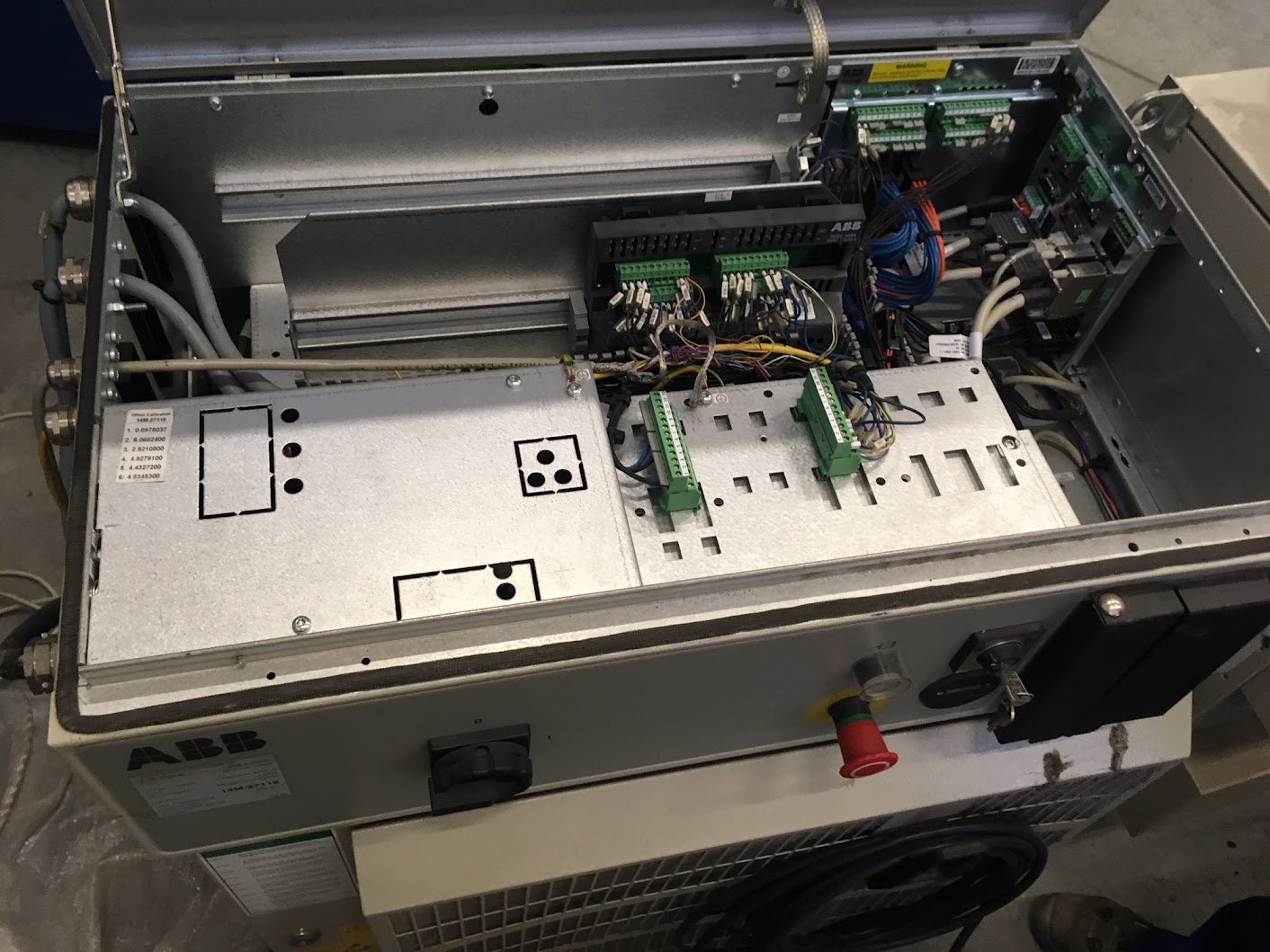

    Where should I find the I/O card/module in an S4C controller?

    The robots were used for "pick and place" tasks so I think they should have I/O card...
    On the other hand I am not familiar with S4C controller (I was "socialized" on IRC5)...
    I would like to use them for plasma cutting...
    I have an offer from the local ABB for cutting software package (Advanced Motion - 3HAC034433001).
    The robots are in a partners facility at the moment, so I have only these pictures... :smiling_face:
    They were manufactured in 2003-2005, an run approx. 35k hours.

  • Bit late to the party, but the lack box in pics 1&3 is your I/O

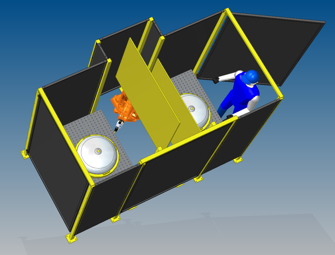

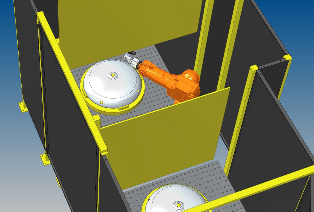

    I'd like to use this robot for cutting lateral holes on tank lids, on a curved surface:
    https://bit.ly/2Euxtzs
    https://bit.ly/2PCeqE9
    Here is a short simulation:
    https://youtu.be/4xRJ2wudCiY
    So, do you think we will need also something like Robotware Arc (like on IRC5)?
